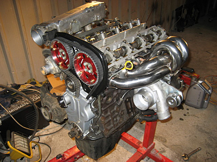

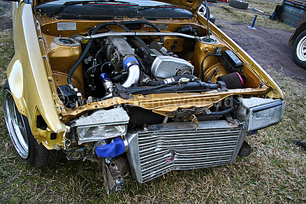

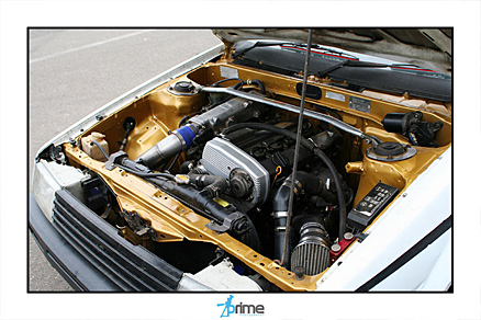

Brad choose a well known but maybe not the most common engine and box conversion for his project: Nissan’s CA18DET. Still trying to keep it simple, he didn’t go overboard on the engine which some people tend to do when swapping engines. A GARRET T28 ball bearing turbo and a Microtech LT8 ECU were adapted to control it all.
Happy with the engine making 148rwkW on 13PSI, Brad then embarked on the other aspects of the car. Focusing on suspension, yet again mating Nissan to Toyota, he went with the S13 front suspension conversion, giving him mountains of lock, bigger brakes and wider track.

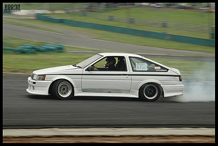

After that he slapped a cage in, some decent wheels and a couple of bucket seats and just hit the track at every opportunity he could. Brad and his little egg Levin started to build a reputation on the circuit in NSW. He and the car both seemed to begin to bond together becoming a great unit. Watching Brad pilot his Levin was something to be seen; especially when he’d be right on the door step of some big-budget power-house drift cars shaking their nerves up!
Brad then spent the most of 2007 driving this ’86 into the ground. He was doing it well; destroying diff centres, body panels and eventually an engine. Brad decided it was time to ditch the pig look and took her apart to rebuild her to a glory fit for his new favourite pastime.

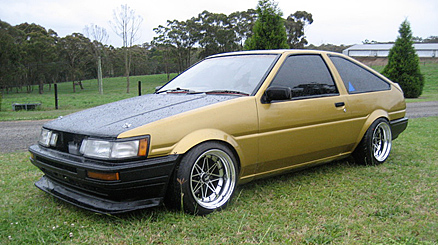

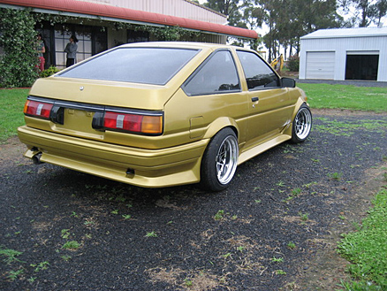

So after some blood, sweet and many hours Brad had finished the transformation of the once white piggy into the gold wearing chicken on roids! Sporting some Work Equips 03’s in 15×8.5 -3 for the front and 15×9 -3 for the rear, it seemed to be the icing on the cake and truly complimented the Vertex body kit and the super low stance giving Brad exactly what he wanted (at the time)…

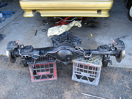

Now in between a lot of driving and modifying, Brad installed an F-series rear diff to try and better handle the abuse and power he was turning through the original diff. Unfortunetly he’d been going through centres faster than a Fat man at a pie eating contest, so to overcome this problem, Brad installed extra oil baffles in the diff which seemed to solve the ‘exploding centre’ problem. Next were the custom rear disk brakes. Using bits from a R31 Skyline and two extra calipers from a VS Commodore for the hydraulic handbrake, the car now locked the way he wanted.
The car now set up for a good punishment, Brad figurd it was time to rebuild the CA18. Parts to go in were; Tomei 256° / 8.5mm lift Camshafts and Tomei Cam Gears to match, some 550cc injectors, a stainless exhaust manifold and dump pipe, an RB20 box to meet the strength of the diff and finally an Extreme Clutch to help with those massive kicks!
After having a show down with a stationary object, Brad had to either repair the metal or go another route, he chose some DMAX FRP guards. At this point the front suspension was changed out. Now some might say ‘downgraded’ others would say ‘improved’ but either way Brad reverted back to the original design of the AE86’s suspension. The setup consisting of a AE86 strut, S13 Tokico shock, 8kg springs, power steering arms, 40mm RCAs, Tune Agent castor rods and some Peugeot 4-pot Brakes to pull this Chikky up!
Being a guy who is never satisfied, again he switched styles; this time back to the minimal look with flared metal guards and kouki Levin front and rear bars. Losing the sideskirts and dropping it further on its arse helped it look even more badass!
